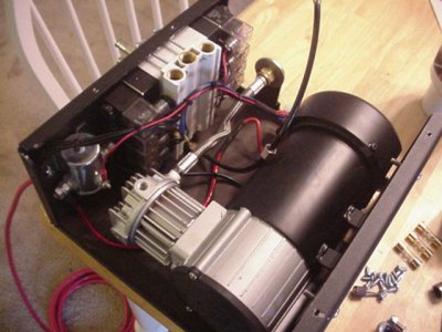

i did it. here are some pics. i also 4-linked at the same time. need more pics, just ask

Did you cobble that up yourself or is that a kit?
If that's a kit, do tell where you got it. That's one sweet setup.
All of the kits for full air suspension I've seen so far won't work with the Western Hauler bed on my truck, your setup has nothing that would interfere ;Sweet

the tires are 33.5 goodyear load range F. 19.5 wheels. got them all from rickson truck wheels http://www.ricksontruck.com/
thats are double edged question. yes and no. the company i used was aim industries, but they had never made a kit for my year of truck. email back and forth for dimensional stuff, check numbers twice, still had to weld everything together, and custom fit every piece with a grinder. if i had to do it again i would call http://www.suicidedoors.com/, or http://www.keldermanairride.com/lift-kits/products/info.php?product=99FRDLIFT4
not that is for my year of truck, i just like there set up better
