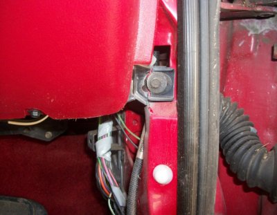

1.the problem.a broken plastic dash mount.
remove the pass side kick panel to gain access to your work area.

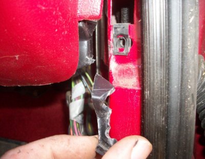

2.the problem.broken plastic in your way to repair.
remove the bolt using a ratchet with an extension and 5/16 socket on the right and discard the broken plastic section.
use just the hacksaw blade in your hand to cut off the broken plastic on the dash side.

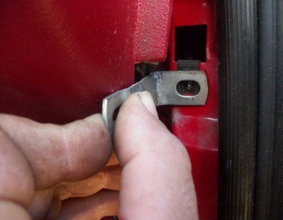

3.the problem.now you need a new mount.
find yourself an L-bracket or make one.i made one using what i quickly found on hand.the flat bar section of a U-bolt found at any hardware store.
put it in a vise and bend to fit using the existing hole for the bolt on the door jam side.

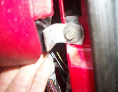

4.the problem.too long.no holes.
cut to fit.mark and drill two holes in your bracket.the screws will make their own in the plastic.

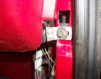

5.the problem.dash hanging down slightly.
lift the dash upward as you screw the two screws in,and tighten the door jam side bolt.put the kick panel back on.

since you have the 9/32 ratchet setup and handy,check out the 4 lower dash bolts too.starting below the power point,under the ash tray and over by your mount repair.you can't miss 'em.in fact you can see one of them in pic 1 below.just make sure they're all snug.
job complete.no more shaking dash or squeaks!
