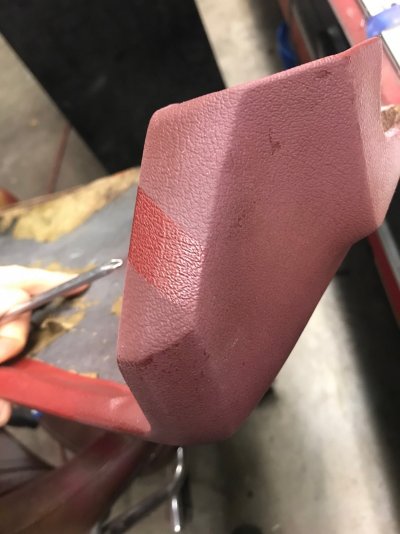

Yeah, I'm not sure what to do on the door panels. Both sides have turned dusty pink due to so much sun damage.
