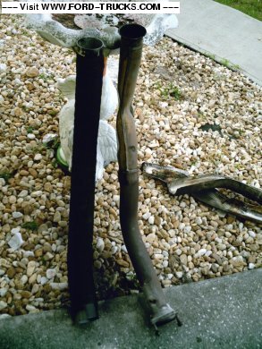

now that you got it running,it's time to start modifying.:sly first course of action: rip out that crushed down pipe and replace it with an uncrushed one.that will let the ponies out.

thats not the restriction.here is the difference between downpipes;
fyi; banks sells a downpipe specifically for the factory ats 093 turbo.

I'll be selling my down pipe in the next few weeks when my upgraded turbo gets here. It's the banks one, I got it in November last year and I have a 3 inch pipe welded to it to connect to a diamond eye power stroke exhaust system. Which hangs in the factory location even on the idis. $50 shipped for whoever wants it.
