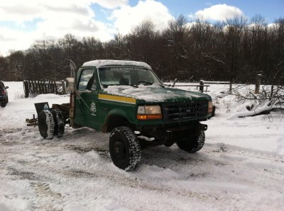

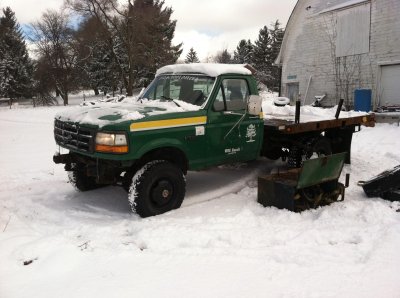

Well like alot of you i thought id start a build thread........
The truck started as an old Davey Tree truck that had lost all hope i initially thought that i would just clean it up maybe put a new cab on it and a conventional pickup bed well it has turned into more than that.....
check it out

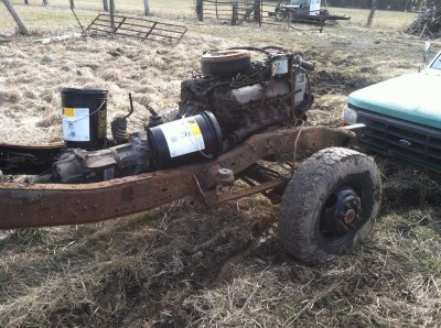

heres what i started with
92 f350 4x4 5 spd cab and chassis 7.3 idi na

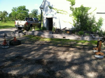

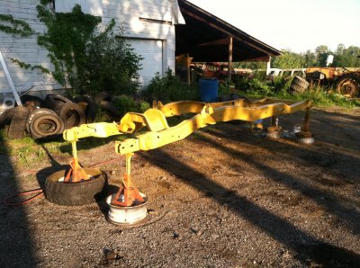

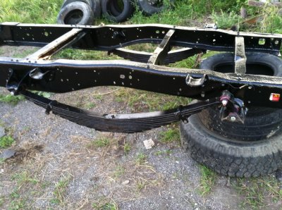

Nrliftedranger
Feb 17, 2013
150
North Royalton Ohio

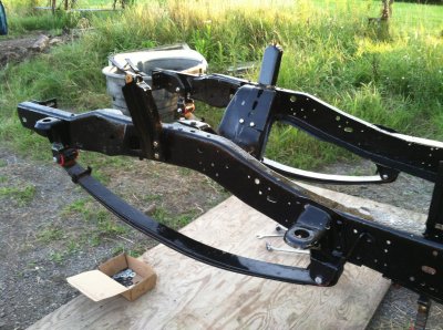

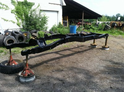

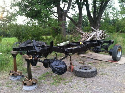

i stripped the frame down had it sandblasted painted it with some free cat primer and 3 coats of eurothane black, i started reasssembly with new springs all around, superduty springs in the front and all poly bushings

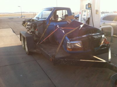

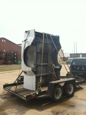

Nrliftedranger
Feb 17, 2013
150
North Royalton Ohio

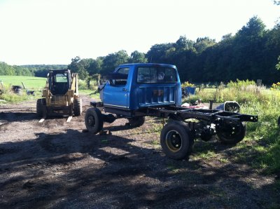

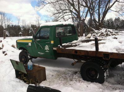

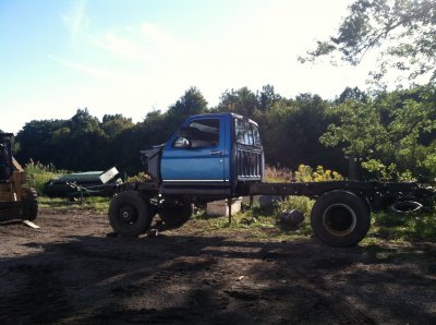

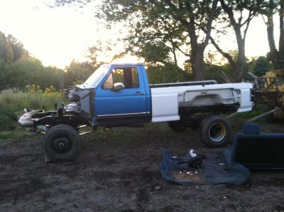

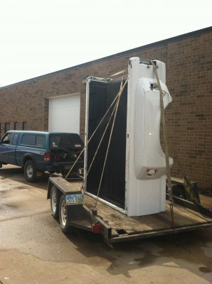

i lucked out and bought a rust free cab and front clip from a guy in kentucky and found a really nice clean bed from a guy locally that bought a truck in florida brought it home to ohio and decided that he wanted a flat bed
Its coming along the final photo is how it looks now

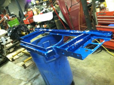

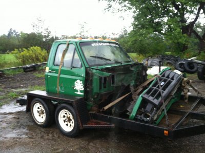

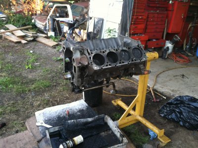

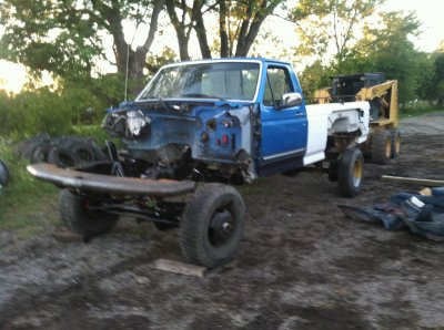

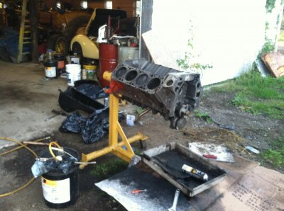

got the motor tore down found out the cam bearings are in need of replacement..... got the core support painted so i can get the front clip on
Scrapped the old cab finally
