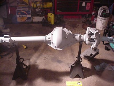

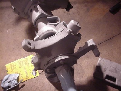

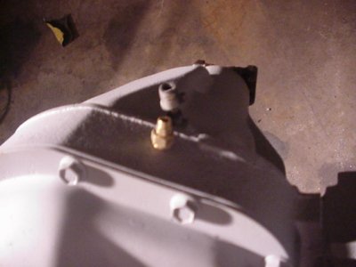

ok, so i got my camera back, unfortunately not in time for the rebuild of the axle. so heres where it stands right now. arb installed, backlash at .009, good pattern on the gears, king pin rebuild on both sides, new u-joints, and primered. my question is since this is a srw front axle can i use the hub/rotor combo and just bolt my dually extensions on over the hub, or am i going to have to find something different?
chris
