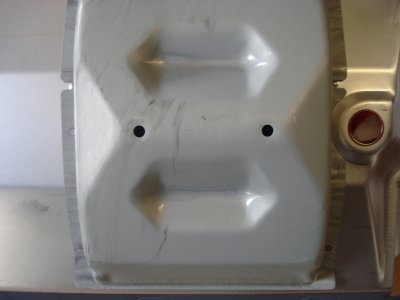

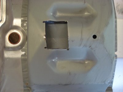

Still need to pull the donor ZF5 and do the typ4 mods. Also, need to open up the drain side of the valley pan for the turbo install.
Ron, didn't you have some photos of those valley pan mods somewhere?

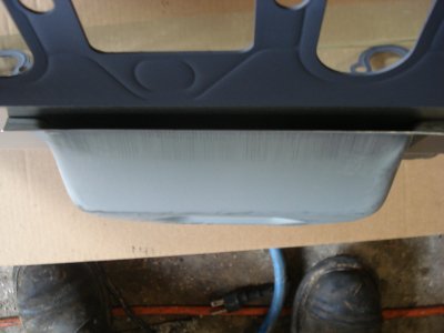

Heath
Yup.:D
The first one is the underside before and the second is the after my die grinder got ahold of it.
In pic #3 the newer valley pans do have a 1/4" gap that does allow for over flow but on a cold winter day, that could fill up very fast and if the turbo drain back grommet is not sealed completely well............ Ya get the picture.:eek:
