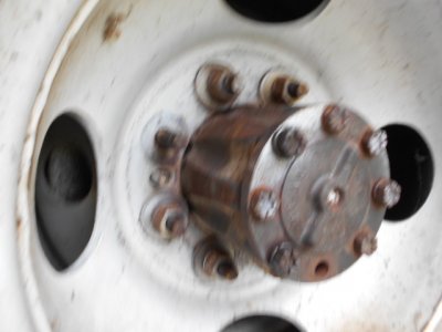

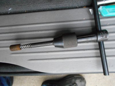

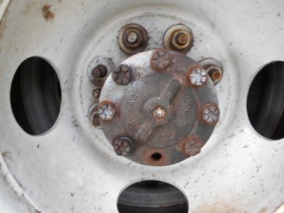

To clear things up, here is a couple of pics of the hub, and the broken bolt. Yeah I know there is a wheel lug missing, anyone have of the nut/ring nuts? Need four, one missing on each wheel.
The damn bolts must be mm, ran a 12-1.75 mm die over them. There a grade 8 for sure, milli muckers grade them different, there damn hard I know, had to drill starting with a 1/16" drill, then keep stepping up to a 7/32" to get a easyout into it. Ruined three sizes of those Craftman left hand drills.
Don't know what rear end it is, Dana or Sterling, but I can pull the shaft out with no problem by just unbolting the hub flange 8 bolts. No oil will come out. Never worked on a rear end before, except on my 84 Motor Home F350 chassis which is the same, only to do new brake shoes.
Now, I'm just going to get new bolts and lock washers. Bolt the SOB up and let her go as is. Yeah, clean out bolt holes good and Blue Loc-Tite.
