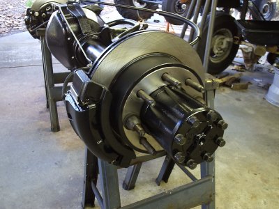

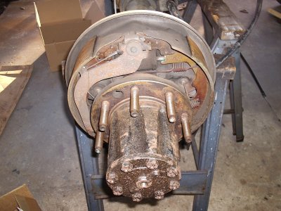

Picture with disc brakes is a 10.25 hub/axle with Dana 60 brakes installed and axle bolts. The bolt heads are bigger.
Picture with drum brakes is a 10.25 hub/axle with the factory brakes and axle bolts. Smaller heads.
I don't have any pics of the bolts out, but they are different at least in this perspective.
