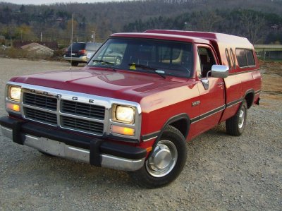

Howdy folks,
Finally did it!
I found a 91 first gen Dodge 2500 with the cummins in it about a week ago:thumbsup:
I've never had a diesel befor so my cherry got popped on this one.
It's in excellent condition. The interior shows no sun fade or evidence of abuse !
It's flat **** CLEAN
The body looks flat fantastic except a couple of dents on the sides of the bed where a tornado missed it but not by much.
It's an LE edition with powerful windows and tilt & cruise
My questions are many and I'm pretty much some what ill informed on the puppy!:confused:
It has the 3sp A727 Transmission and a 307 gear in the rear.
I'm thinking about swapping the tranny for an overdrive unit! (Egads):eek:
So how would I go about doing this?
I know I gotta go by the cournles and sacrifice a couple of chikens (did that At the buffett the other night)LOL
I know I'll have to Dig way to deep into my meager funds, sell two of my other gas burrners and the 91 oldsmobubble with 67 k miles, have a yard sale and quit feeding the cat, nah won't do that .... I'll just eat it:rotflmao
Any performance mods Y'all can come up with that' step it up a bit BUT keep lt rolling as it should. Look at as a truck that I can drive my friends to the parts store for the next 10 years or so:sly
Thanks in advance for your help!
Slim

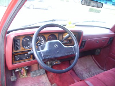

Hey Guys, thanks for the heads up on the tranny situation. Sorry it took so long to reply, had to get it out and drive it around the hills up here in Rkansas. It is a sweet one. smooth riding with the original shocks ( I think) no real bad habbits other than the missing over drive! I hadnt owned one with out it since "Broomhilda" the lwb 80 Ford with the extended cab, I wound up replacing just about every thing on her including the driver! (Serious POS!) :puke:
I took Her (Red dodge yet to be named)up to Hardy Arkansas and snapped a few pics. If I can get the demons out of the pooter I'll post them and let Y'all have a look see!
It is an LE Series with tilt cruise, Auto (of course) pw, Pdl, Etc, The bed looks like it's almost new! no scratches to speak of and no dents. The interior is just as good! There a couple small dents on both sides of the bed from a tornado that flung some stuff towars it! Not bad but there. Both bumpers are Dingless as well!
