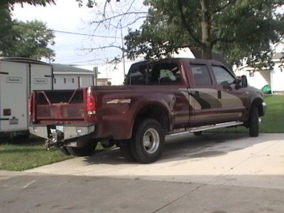

My MPG is way down from 16 -18 to around 9 now. Changed fuel filter (see fuel filter thread). Got the KN air filter, gonna clean that today. Only got 182K on the clock. Traveled to Alaska, 15K miles RT and got 11.5 towing a 30" 5er. Think I'll sell my PSD and keep my 92 IDI with the GV U/O.
