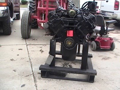

342
I just shipped a u-haul engine on that rack if you seen it. Weighed weight was 936#, that was without starter, alt, a/c comp, vac pump, fan and flywheel/flexplate.
