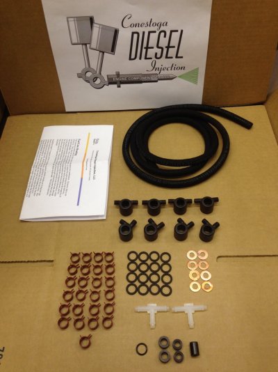

The image below is the kit i installed from Conestoga Diesel. I looked on McMaster Carr for Vibrolock and couldn't find anything on their site to compare to what your calling a Vibrolock.

It looks like there are some olives in the picture of the kit. Mel would include the better viton o-rings so those should be good. Here is what I bought at McMaster:
