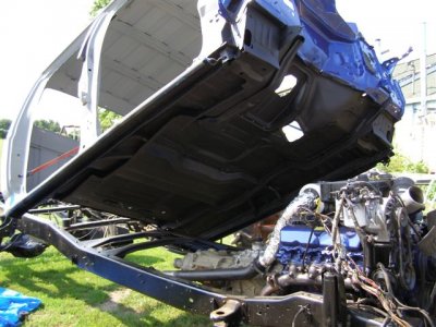

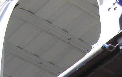

Here's a few pics of what the mounting points look like with the headliner removed.

These braces look evenly spaced. what is the chance of finding these without removing the liner? and installing the 2nd light? Or drop it and modify some of the trim to hold some rear speakers?
