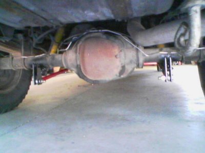

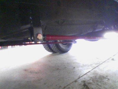

I know I've posted this before but heres my setup. Night and day difference in the way the truck handled. I towed heavy on a regular basis with this truck.

not mine but you get the idea. it is not needed on both sides. one is fine.
