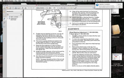

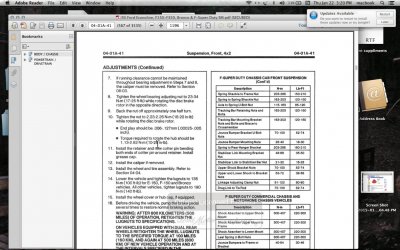

From The Ford Manual
Here are the pages from the 1993 2wd section

Thanks for all of the helpful information. I ended up torquing spindle nuts to 50 ft lbs and then backed them off 1/4 turn. I talked to a few more people about it today and this seems to be the best way to pre-load wheel bearings. Same procedure is done with some semi trucks too.
