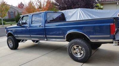

Any one know where this leak would be, thought it was water pump but I just replaced it.
Water leaking out the big round thing.

Yep, that's your water pump. Lol
Possibly thermostat, but more likely water pump.

Maybe I screwed up the install of water pump, I also replaced thermostat and it's leaking more than before I started this. I really need a brand new truck, what can I get for this as is. Truck is 94 with 113k and body is clean as they come? I don't want to mess with this no more...Interior is almost perfect and just put 2k into wheels and tires last week.

Thermostat bolts need rtv on the threads... At least the bottom one does. It threads into the coolant passage. After resealing my thermostat housing three times I realized it

I had read that before, and youtubed it, on you tube it shows different ones than mine but I am not sure what year truck he was changing water pump on. All my bolts are same size except for 3 I think. I Wasn't sure exactly which one so I put thread sealant on all of them. I guess I just didn't seal up something correctly.

Hope you put the two short bolts in the top two holes, long ones can bottom out on the IP drive gear. Did you use a gasket or just RTV ?

I labled bolts and put them in same spots. I used the gasket that it came with along with rtv. which should I use on my second attempt? A mechanic maybe :)

Check tech articles..there is a write ups on water pump...and thermostat....clearly indicates some very key points..materials to use etc.

Make sure you dry up any coolant from the ports so it doesn't run down and mess with your rtv.

I had the same a few thousand miles after a new water pump install. I found it was the upper radiator hose leaking at the clamp and following thermostat housing down and around
