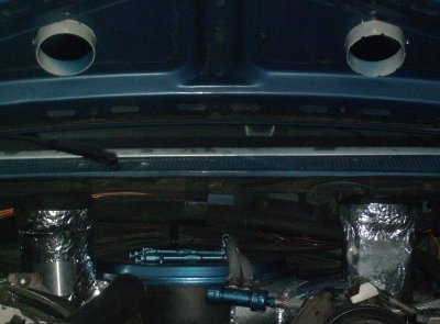

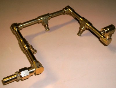

BioFarmer93 where did you mount your nozzles in your n/a application?
@dsltech83- I drilled holes through the top of my stock air cleaner cover and angled the spray nozzles to center on the intake throat. Here's a couple photos- and yes the brass was painted blue to match the cleaner cover. I had to tell you that because the spray manifold may be hard to pick out in the photo, that's why I included a shot of the manifold for orientation.
@rjjp- The system as it is currently sized can spray about 4 gallons an hour.
