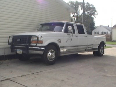

What I'm trading 2006 F150 XLT 4x4
What I'm getting if I don't get cold feet
338
That 97 sure looks like a 92 to me. See Avatar and pic below.

I want powerstroke because I've outgrown the half ton, and both of my IDI's are reg cabs which suck trying to take my son, wife and two dogs (one is 180lbs) anywhere. The 97 is a F250 with the dually conversion, would rather a f350 but it'll do. I haul 5,000-18,000lbs regularly from distances ranging 100-1200km on average depending where I'm headed. This will become the haul truck and I'm going to keep driving my million miler 6.9 idi as my commuter to work. Also I'm a heavy duty diesel tech and despise working on gas motors honestly and the 5.4l triton is known for motor issues so I'd like to get rid of it while it's running good
In a former life,I worked at a local U.B.C. and oneof the company trucks used for deliveries and that was a '97 F350 Dually with a flatbed and a 351 Windsor/5-speed. The light duty trucks( F150) are the only ones that had the body change in '97, I think the rest of the line didn't get changed until the early '99 'Super Duty truck body rolled around.
