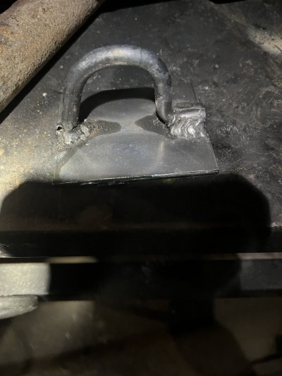

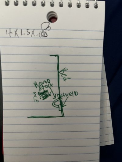

I’ve been wanting to do this for 2 years now but been lazy but I need to deliver expensive doors an hour away so I need to make a tie down hook tonight
Does this look sound?
I have a pile of metal an oxy torch and a welder so can do about anything

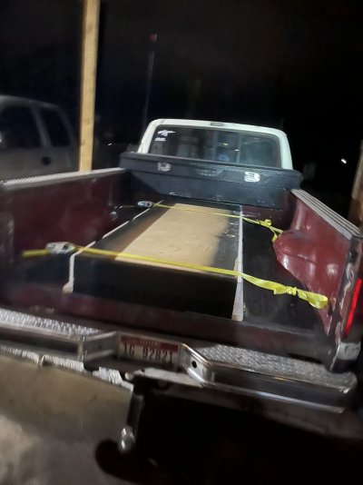

I was looking at your picture again.
The type of cargo you are hauling
having the tie downs down low, is really
the best way to secure them.
Having the tie downs up higher would not have worked.
My inside "D" Rings are mounted where that horizontal line is in the stamping in the sheet metal.
They work good tying down an engine.
I have mentioned to guys with new trucks, that they need some tie downs. "OH, I wouldn`t want to spoil the looks of my truck". "There is the 4 tie down hooks".
Lot of good they are, have a load of box`s and cannot get to them.
I really laugh at people trying to haul something, like moving. They have their ropes around the trailer hitch, ends of the bumper, over the side around the leaf springs etc.... comical.

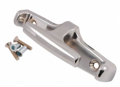

My thought was the factory ones on the outside that you pictured but in the bed

@Austin86250 if the doors have glass, I don’t think it’s large enough to break, but I have heard that things with large panes of glass can break it laid flat.
My trailer like @IDIBRONCO ’s has had tie downs just like @Nero ’s pickup for over 20 years. Only difference is I put mine in the bed vs the wall. Used fender washers. I also have 10 marine type cleats around the perimeter that have been priceless.
Looks great. My only thought, would you want to reinforce them so they are in double sheer in case you have some tall and top heavy in your bed strapped down? I might not be understanding your photo good though. :cheers:

My only thought with the out side one`s on the inside, is they could snag things as they would stick out some. I don`t know if they are a cast pot metal, and could break off it hit hard enough. All depends on what each of us use our trucks for.
The "D" Rings do hang down flat on the sides.
If on the bed floor they would lay flat.
I have the rubber mat that came from Ford when the truck was new.
When I pulled my Bed several years back, I had to cut off the old Bolts, and replace with regular Hex head bolts. Things cold get snagged on them, but the thin rubber mat keeps that from happening.
