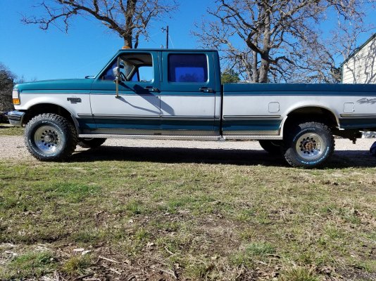

The stock 235/85/16 is 31.73" I went to a 255/85/16 which is 33.07" This was a larger increase than you may think. First gear now has a purpose and makes the truck acts more like it should have been from the factory. I have the 4.10's and 4wd and zf5. I don't want to say don't do it but you may regret going to 35's and 3.73's if towing up and down hills.

Nice looking pickup @SirRea63l.
Though mine are 16.5", I think we have the same wheels.
Thanks, they were budget friendly American Racing AR62 Outlaw II in a 16x8. Going to the slightly larger diameter tires was one of the best things I have done for drivability of the truck, I am glad I did not go any larger. I don't work this this truck but the overall gearing change from larger diameter wheels worked perfect, larger ones may have been too much in my case.
