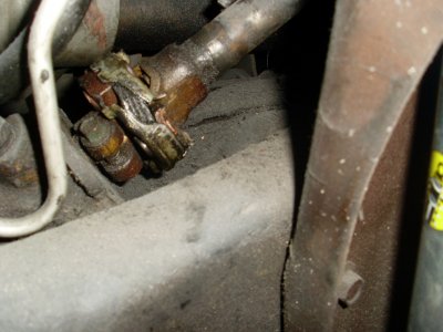

okay i decided to get dirty and find out where my leak was coming from. turns out the return line is leaking right on top of the shaft where it connects to the box. it has that plastic thing over it but from what i can feel ( i couldnt get it off unless i broke it) the joint under there is completely saturated. i'm sure that's not good. i'm gonna try a new shaft and hope for the best. found a borg for 199 shipped, might as well jump on it.
this is what's hiding under the shaft cover. it's the rubber biscuit I was talking about earlier. if you get a later steering shaft assy, the rubber is now synthetic so it's oil resistant and you get the u-joint where the trunnion used to be. be sure to reinstall the plastic cover. if you ever get any rocks kicked up there and the cover is missing, you may actually jam your steering.

Just a note of information. See the two distint shafts and the collar. Well this is a safety slip joint just incase your in a heand on collision. The shafts will slip into each other and not send the steering wheel thru your chest. Also in this joint is a flat spring about 1/2 inch wide and 3/4 inch long in a plastic sleeve. Thats breaks sometimes and you get all kinds of slop between the two shafts. Its hell to get in there too but go shopping at a wrecking yard and learn how to on there stuff first. Be sure to get the parts off the truck that looks like your shaft parts. There are some differances here.

Thanks for the info. Unfortunetly, the entire shaft moves with the same amount of free play. Not just one half, or the other. I didn't want to break the plastic shield off the box end of the shaft but i'm assuming from what people here are suggesting, that the joint there is shot. We'll find out when the new shaft comes in.
