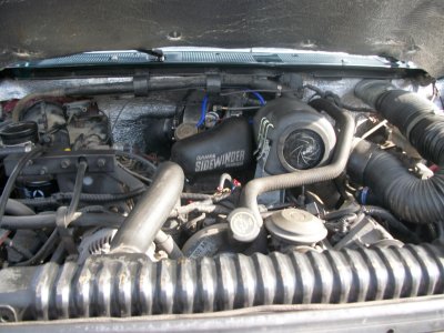

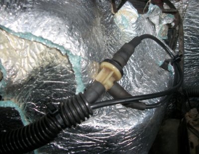

http://www.lobucrod.com/
i put two layers of this just about everywhere in the cab.all but under the headliner now i guess.it really helped a lot.
i dunno how this compares to other stuff:
Q: What are the sound deadening properties of the insulation?
A: Low-E has had this product tested for noise reduction using the ASTM E90-90 method. At 125 HZ the noise reduction is 23 DB. At 400 HZ the reduction is 42 DB.
RLDSL
Diesel fuel abuser
Dec 14, 2005
7,701
21
Arkansas
That is some great stuff . Been using it for years. Especially good for places like evaporator boxes to blocking radiant heat from the engine from ruining your AC performance. Works great in headliners too for blocking out heat
