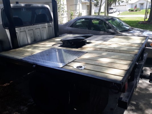

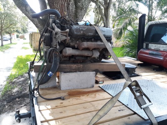

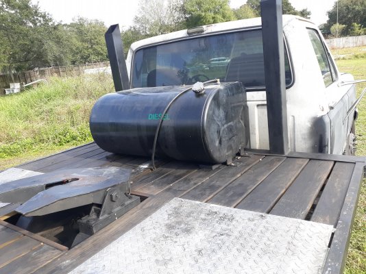

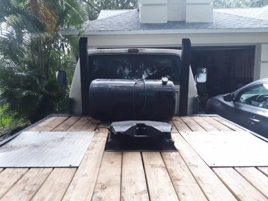

its amazing how ugly a truck can get when used as a tow pig for a few years especially a truck bed it was all pretty now its ugly as can be notice last pic is after like 1-2 years of working it trust me its really ugly now same truck from this video
LOL
