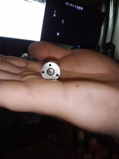

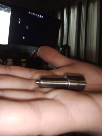

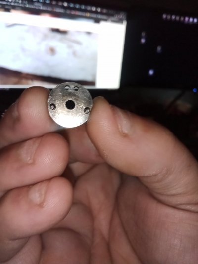

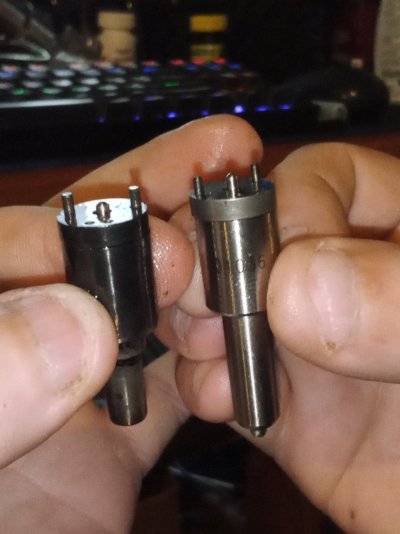

I have these marine nozzels and curiosity had me inspect what the difference was...
First I see this port dose not line up and not sure if is a issue.
For the port to line up this pin would need redrilled in the nozzel
As for needle pin being shorter, this spacer would need drilled for the spring seat to pass.
It dose assemble and has the nozzel tight, just the extra length of the raised shank would keep a washer from seating. It will screew down into the head so the tip size is not a issue.
odd yours are a bit different than ones i have I am wondering if maybe the ones they sent you are wrong will have to get pics of the injector nozzles I have here I dug some out that I need to machine soon mine do not have the stepdown like the ones you got also mine are much bigger around that is just odd as for where the the end of the center needle sets in the housing being a slight bit longer mine are only a hair longer and my fuel ports line up perfectly also my mid plate between thev nozzle and injector body has 2 ports the left one is used on our bodies as is the one on my nozzles both the old ones and the new ones.
I also wanted to point out as the Booyah45828 mentions to run these you have to delete the glowplugs physically or they will delete themselfs into a piston LOL
Yes is odd and guess will try returning the ones I got, since they needle dose not extend past the spacer to get to the spring. I will be physically deleting the plugs, just need to think on it.
