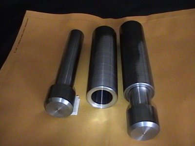

This is the tool needed to install the disc plugs. They are pretty expensive to buy. Had a guy that used to make, sold 8 or 10 of them on here, maybe someone has one close to you. IIRC $250 store bought.
The pic shows it assembled wrong, the small end is what dimples the disc, the barrel end has a specific curved radius to fit the disc plug.

Bill, do you have a print of that tool, dimensions? have equip. to make one and anticipate its use on a 6.9 rebuild

Is making this tool the most available option? I've searched around a bit with no luck. None of this idi stuff is a dime a dozen haha

I have some of the tools available,made some when I was slow in the shop earlier this year. PM me,I can sell you one or possible rent it to you.
