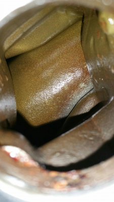

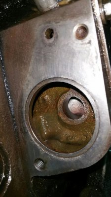

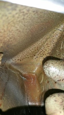

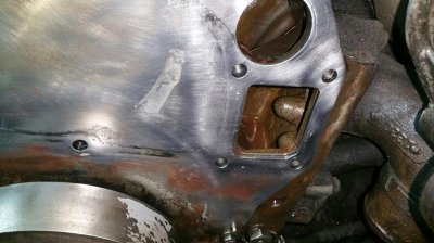

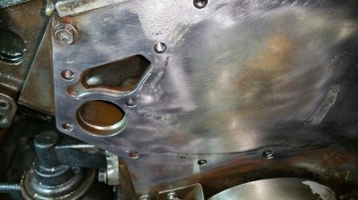

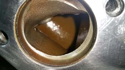

Here is inside of my 200k engine, had green coolant when i got it, radiator cap that didnt hold presssure, previous owner knew nothing of SCAs, engine didnt seem too well cared for, but the nitrite did what i consider an excellent job fo protecting the iron surface for 26 years
