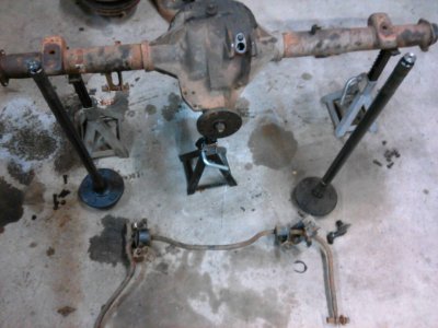

tore the Dana 35 down and started cleaning it up.
I'm going to replace all the axle shaft ujoints and the wheel bearings, and the pivot bushings. Everything with the pumpkin seems tight, so I'll just clean up the housing and bolt it back up.
I was happy I found this one, along with its matching 8.8 rear end because it already has the gear ratio that I want.

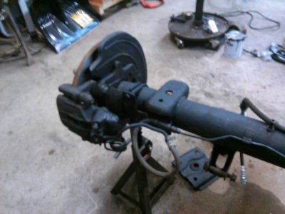

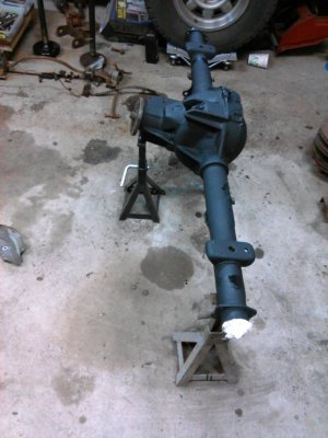

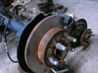

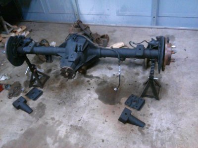

got the 8.8 all cleaned up with new wheel bearings, and oil seals. also converted it to disc brakes. Its just an open carrier, a locker is in the future plans, but just not in the budget for this phase.
I installed it under the truck tonight, now on to drive shafts... :D

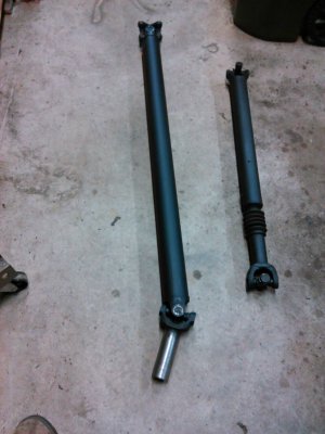

red cent gets shafted
got the drive shafts figured out.
I was able to find a rear drive shaft from a 2 door explorer that happened to be the perfect length for the front shaft. And I special ordered a rear shaft with just the right length.
got them both painted up and in the truck.

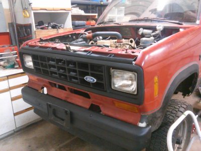

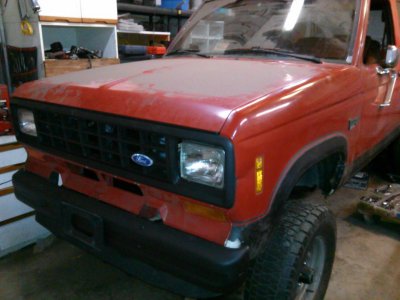

Been making a lot of progress.
Got the exhaust done. I went 3" from the turbo back to a 1st gen dodge cummins muffler, and 3" from there out the back just behind the right rear tire. (stock tail pipe location)
I tried to take pictures but without a shop lift they really arent worth posting, you just cant tell what you are looking at.
Got the front clip back on, and all the under hood wiring done. Radiator hoses hooked up. Hydroboost all plumbed in and functional.
I plan to add an intercooler eventually, but not at this time, so the stock crossover pipe it is. Well, after I modified it to fit the new turbo location anyway.

looks like a custom hood is in order!
awesome stuff!
makes me want to go buy a ranger
Believe it or not, the hood just barely fits, I have about 1/4" clearance between the crossover pipe and the hood blanket. :rock:
Anyway, thanks for the nice comments guys.
