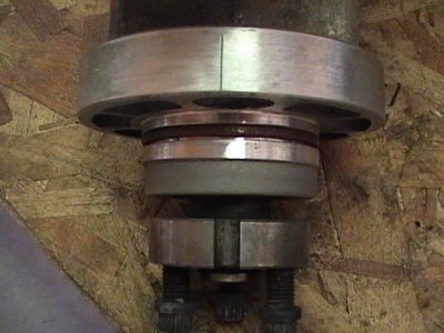

so today i am pulling the pump
1st surprise.. i started the truck and it imidiatley jumped to 1500 rpms for a bout 30 seconds till i got my bearings and shut the key off. tried it again and ran fine..
now i am at the point of pulling it out and the it seems to want to pull the gear with the dowel in it(the one with the black 5/16 bolts) out. and when i look at the base of the pump there is a shaft sticking out of the end that it is hanging up on. i do not wana pull it to hard and break anything. what is this and could this be related to my problem?

Starting a cold engine, the HI idle solenoid energizes until the pass head reaches 120*F, then de-energizes, depending on how far the plunger that pushes the throttle tab is how fast the idle speed is.
Pulling the IP, remove the three 5/16" screws that hold the IP to the gear, then the IP should pull out of the gear tower, DO NOT REMOVE THE BOLTS THAT HOLD THE GEAR TOWER TO THE ENGINE. The IP has an O'ring around the flange, that makes it hard to remove sometimes. If you have a rubber hammer, tap the IP with that to start it out.
Don't know what your referring to by a shaft sticking out the bottom of the IP. The dowel pin is just a driver attached to the gear and goes in a slot on the IP.
Looking at the IP pic , where is the shaft sticking out?

pump shaft snap ring
"Starting a cold engine, the HI idle solenoid energizes until the pass head reaches 120*F, then de-energizes, depending on how far the plunger that pushes the throttle tab is how fast the idle speed is.'
well my cold idel doesnt touvh the throtel due to it being bend away. but dang that was scary
and well by shaft i meant the shaft in the pump. i had to remove lines to get it out safley but yeajh. looks like mybe the snap rings were assembled backwords or they just slipped out. cuase the shaft was completley loose in there:eek:

Oh, chit. The shaft broke?
Sent from my SM-G900R4 using Tapatalk
no shaft is fine it just appears that snap rings used to hold it in place malfuctioned and let it loose only allowing the 3 bolts to hold it in. yes tht was deffinatly my problem.. at least a problem:***:
