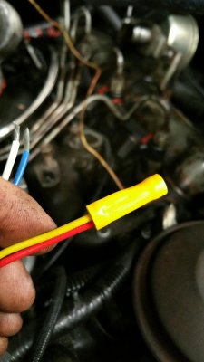

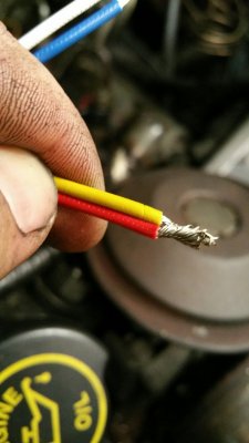

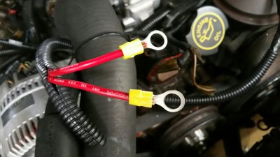

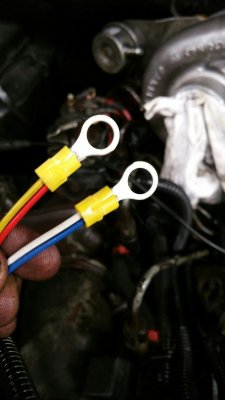

I crimped 2 together and ran a 10 gauge wire for each of the two sets on the driver side, i crimped 2 together with a ring terminal on the passenger side, the harness was long enough without extending it. I ended up not relocating my glow plug controller as it was much less crowded with the fuel filter and bracket removed
