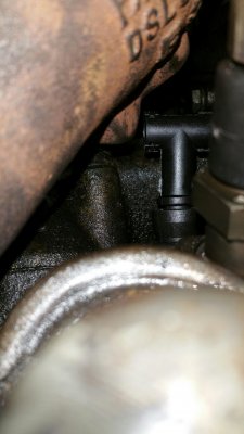

I will admit i'm a little concerned about how close the #7 plug is to my factory turbo up pipe. The wiring inside is tight to the bend so i dont think the wiring will be damaged and as long as the empty "T" connector just melts rather than catches fit it will be fine.

Maybe put a spark plug boot insulator on that #7 plug to help protect it from the heat

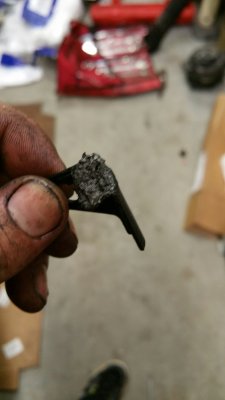

I had a piece of the material left from the connector i removed. I heated it up gradually with map torch it just smoked a little no flame caught. Then i directly blasted the piece with the blue flame and it still didnt catch. It seems to be made of a non flamable plastic. So i'm going to let it ride and shape itself.

Should be fine if it won't ignite then. Permitting when it melts it doesn't expose any wires. I'd still go with the insulator myself, but your truck, your will.

The wire is pulled forward to the 90 bend in that tee fitting, i think it'll be ok. If not, i'll buy another and let you guys know haha.
