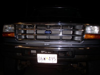

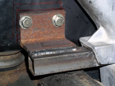

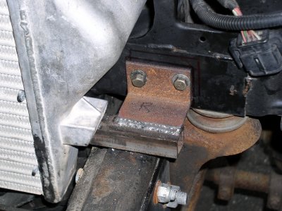

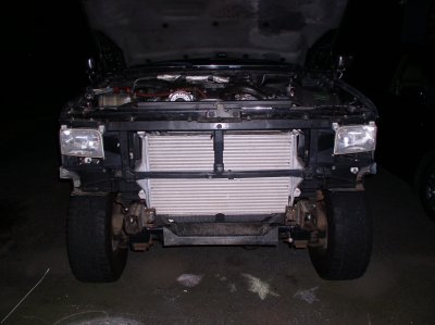

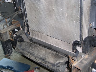

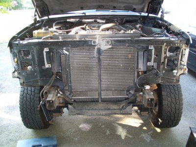

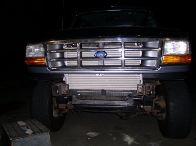

Finally got around to installing the I/C behind the grill. Haven't done the tubes yet. Heres some pictures:

thanks for the pics. I like your lower brackets;Sweet
+1 on that!
How much space is there between the front of the intercooler and the back of the grille? And, for that matter, how much space is there behind the intercooler? Do you think the intercooler could be moved further aft (i.e. closer to the radiator) if the a/c condenser wasn't there, or is there something else keeping it from going further aft?
I ask because I'm preparing to do an install very similar to yours (including swapping to an OBS front clip), but I want to relocate the a/c condenser so that it's forward of the intercooler...would love to get an idea of how much space I'm going to have to play with. I've got a few ideas on this, actually... :sly
