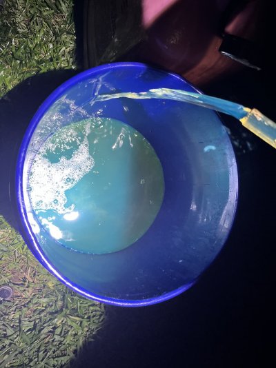

So I took my truck to the local gas Station to fill up…rode fine there and on my way home is was bogging down be egt was way over and I got home and I was leaking fluid from my gas tank. I have a receipt that I got diesel and got it at a diesel pump and I got it syphoned out and this is what came out. Definitely not diesel and had alot of back pressure and squirted out of the tank. What should I do as far as cleaning the system? Any ideas what it could be? I got it at a shell

You said it isn't diesel so what does it smell like? Did it have water in it? The picture isn't quite enough to know what was pumped into your truck. Was it possibly mix with regular gasoline? I doubt it's anything crazy like a terrorist gas tank filler but as far as removing it i'd get a small pump and remove as much as possible into a tank and see if it separates water out of it.
Also a lot of pressure building up in the fuel tank doesn't sound right either...
Maybe someone else can chime in on this

Gas in a small quantity is not going to hurt anything. Drain the tank, fill it up with real diesel, fire it up, your ruff run problems should go away in a minute or two. EGT going nuts tells me the gas ratio was a bit high.

That’s the problem we have no idea what it is at all. Should I replace my fuel pump? I drained the tank and replaced the filter. Anything else I should do to help it?

No need to clean anything, just empty as much you can and refill it to the brim with some high quality diesel and it will flush that all away.
