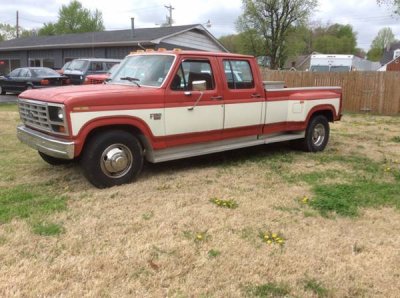

Just started driving home and got her up to 65 and blew the water pump and radiator and fan are shot now too. Hope to get her up and running soon. With a c6 I should still be able to go 60 65 right?

really depends on your gears.
in my 87 with 3.55's, a 7.3 and T19 i could do 70 max!
with my ZF swap, i can burry the needle if i wanted to.
for rust preventive measures, i choose POR 15
nice truck
14,778
483
2000 rpm on my truck...74 km 2200 bout almost 90
C6 3.55 w 255/85/16 tyres.
Guys here like to spin up to 3600 rpm...me I want to be bout 18-22 max...spinning costs fuel...
Have fun enjoy the truck....in for a penny I say in for a pound...replace tstat now while rad wp n such is getting done. Ford Motorcraft or IH tstat only no cheapnese offshorecrappola from cheap auto partz store.
As other said, it depends on the gearing.
With a C6 and 3.54 gears in my old van, I could bury the 85 mph needle...not that I ever did it :angel:
I drove a U-Haul with a C5 and 4.10's once, and the engine hit the governor at 70 mph :shocked:
Nice looking truck ;Sweet I'll be following to see what others have to say about rust prevention...
