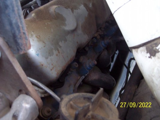

Also I don’t know if it has head studs or just the bolts, is that something I should be worried about with this turbo set up?
It's easy to tell whether you have bolts or studs by looking. Bolts will have a solid head, while studs will have threads sticking up above the nut. You should be fine with your current set up. Most of those made about 8-10 PSI. The later ones like the ATS 093 and the second gen Banks Sidewinder (both of which are wastegated) will make in the 12 PSI range of boost. With that much boost, you'd definitely want to start thinking about studs.
