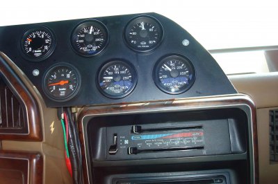

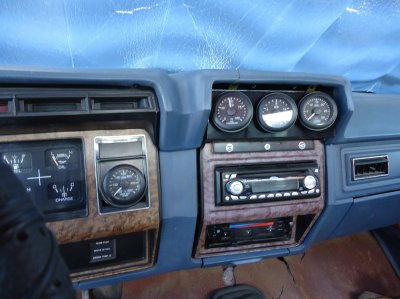

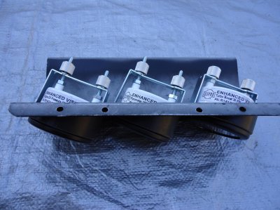

Sorry for the hijack, but here is where I put gauges in my '85. 2" gauges fit in 2"ABS pipe, so you can create something to suit.
