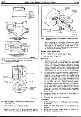

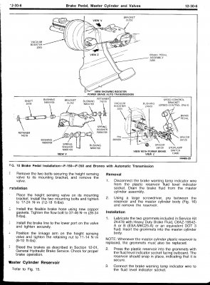

The line your holding in the fifth pic looks like the AC hi side line to the condensor. No Vaccum line has a metal fitting on the end. To check the booster for vac, after running a minute or so, pull the check valve out of the booster, should hear a rush of air going into it.
These pics might help.
