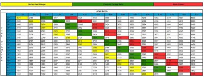

I'd like to go 3.55. 3.73 wouldn't be a big change, but for my driving may be worth it
14,778
483
I see.
Need 4.10's to tow...and run the 38's LOL
Also only seeing as it is only a 450 RPM diff between the two so a 3.73 would barely be worth effort to swap IMHO.

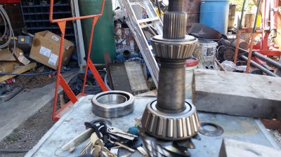

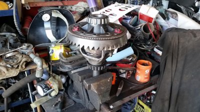

Installed 4.10 ring gear...but need to clean all bolts apply locktite blue and torque to spec. Guess figure out how to hold case and torgue bolts...hmm..mod an axle to hold it in vice I am thinking myself...
attachment.php
attachment.php
Pinion races are now in deep freeze....
attachment.php
Thats where I am currently...just going to lookup all specs for torque specifications and prep for final assembly soon.

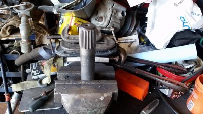

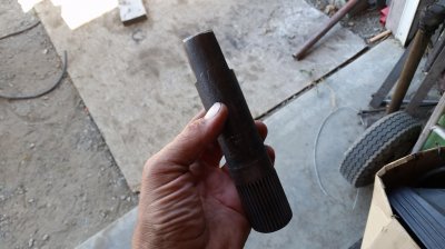

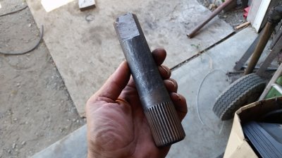

Cut 1 of my spare axles...set it up in a vice...leveled axle stub then with a fresh ginding disc cut two flats...using a level again to get as close to parrallel flats as I could...turned out well.
attachment.php
attachment.php
Now I have a slick lil tool for these axles
attachment.php

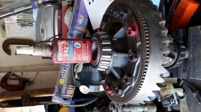

Installing and torquing to 120 lbs feet with Blue 242 lock tite
attachment.php
Done Red heads are for tracking start and criss cross pattern torquing bolts...
