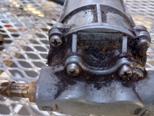

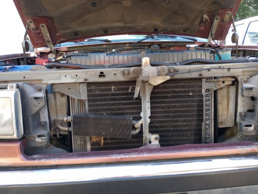

Ok, snow has melted... It is an add on. Fittings added to each access/side/PTO cover. 1/8" npt to 5/16" hose barb fitting in each cover. One, passenger side, about 1" up from bottom edge of cover, the other, driver side, is about 3" up from the bottom edge. Hose on drivers side is connected inlet side of a Walbro 12v-801 fuel pump bolted to the cross member. Pump out connects to 5/16" aluminum line that runs along crossmember to pass side frame rail, then runs forward to the radiator area. Hoses connect to the cooler mounted in front of the A/C condenser. Hose connects to aluminium line back to passenger side of transmission. Hose connects aluminium line to hose Barb fitting on pass side transmission cover. Pump is controlled by a toggle switch on the dash. No temperature gauge was installed. I'm currently installing a gauge. Bench test showed the Walbro to be intermittent when powered on. Given the age and non availability of the Walbro. I will replace the Walbro with a Holley "Red" pump. I will also change the flow to out on the lower passenger side and in on the higher side port.

Very cool, got more pics for us? where does the pump mount? To be honest, NPT fittings screwed into the PTO Covers sounds like a hack job to me but maybe thats the best way to do it. Couldnt one line be plumbed from the drain port and the other plumbed to the fill port? Maybe the drain port fitting would be too exposed to road debris and damage but a skid plate could be made to shield it.
