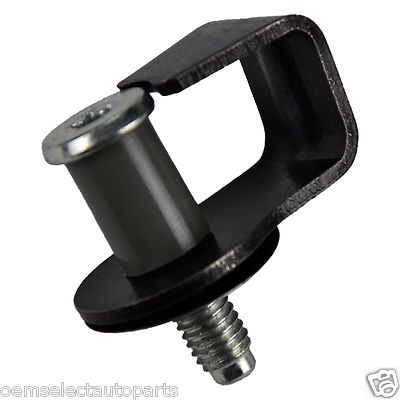

Iam a frequent flyier at PNP and with a T50 Bit and my handy electric Impact gun have removed quite a few strikers. The one`s that unscrew, and the Bushings look good, I grab them. The Pass door side are usually in good shape, and some Vans or explorers use these on the back doors also. I now have a bucket full of them. :sly
The Bushings are a bit thicker than the Pex.
Here is a picture from Auto Zoo of the Striker.
This one is $16, but seen them much lower
and then good old E-Bay, bless their heart, only $43.70.
I think Ford went with the Bracket because people were catching their coats etc... when getting out of the vehicle.
Here is a whole bag for $16.50, hey Christmas is coming up, great Stocking stuffers...LOL
