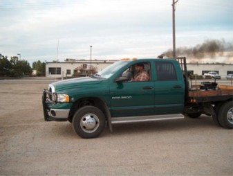

if ya use the 50hp level ya shouldnt need guages since ya dont tow. the 90hp level ya may be ok if ya dont hold the go pedal down for a long duration. i wouldnt want to go guageless though. my 3gens had 2 pyros, a boost, a fuel prssr guage, trans temp on tranny and rear. if i was doing it id go analog guages and do all of em just to be safe. they can transfer over to the next truck ya get in a year along with the dl'er
