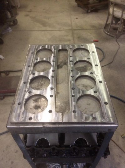

i actually had plates made for the deck to bolt on so i can pressure test.
aluminum plates to cover the coolant in, and oil cooler mounts and add 20 psi of air, after i filled with water.
if the bores and bearings look good, along with the piston faces, and the pressure test checks out, i would have the heads done and get it back together,
