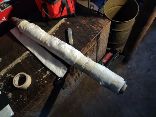

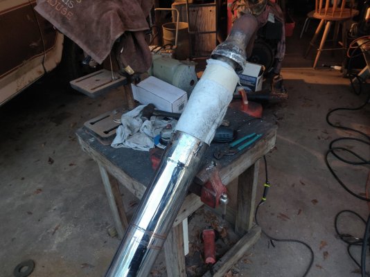

I got home early enough today to do one of my "glass pack stacks". It's not to hard, the pictures are pretty self explanatory. But dude! @Nero , I've only done one and it's A LOT BETTER! After I get the passenger side done and everything welded back together I'll drive it and see what's up. But just reving it in the driveway was WAY different. I'm speculating that it's going to sound like a slightly mellowed out hot rod, loud when you get on it and rumbly with regular driving. I'll report more tomorrow.

Well, had you read the whole thing you would have found out that I'm actually making my own glass packs and putting them into the stacks themselves. No worries though. I ended up doing my own exhaust, it was wayyyy too loud, and now I'm shutting it up hopefully. You don't have to read the back story, just hop on the bus here.

EXTRA!! EXTRA!! READ ALL ABOUT IT!!!, Redneck invents glass pack muffler and shuts up obnoxious diesel tow truck!!! My goodness, it's so different and quiet and nice. I can HEAR my engine clatter like a diesel and all the racket that a ZF5 makes. I had figured that the ZF5 in the tow truck was better than the one in my dually because it didn't make all the rollover noise, but it DOES make the noise, I just couldn't hear it. Really, its quiet enough that I could be a repo man and snag cars out of drive ways at 2am and probably wouldn't upset the dogs. I wish I could have done a before and after video, but guys..... well.....I'm so untechnilogical that I drive a mechanically injected diesel and make my own glass packs. If any of you want stacks, but want quiet, this WORKS!!!!!! I'm sooo happy, as if you can't tell!!!!

I had to deliver a horse trailer about 15miles away, and it does rumble like you expect, but mellowed out hot rod is a good discription. No poppy stuff. It "feels" like it has more power, but what it is is I'm actually pressing the accelerator harder because it's not screaming in my ear. If I put a 12" glass pack just behind the engine, I bet it would make it even quieter. But I'm good with it as it is.

Thank you! As far as installed pics, well there's nothing to look at. The idea was that I didn't have anywhere for a muffler, so I invented something and hid it in the stacks. It looks exactly like it has except its quiet.

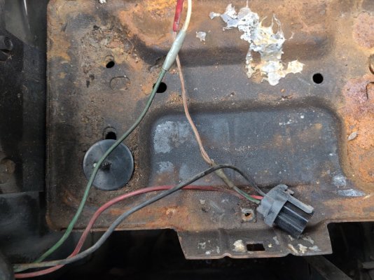

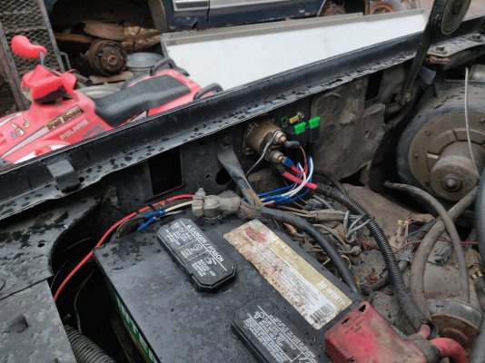

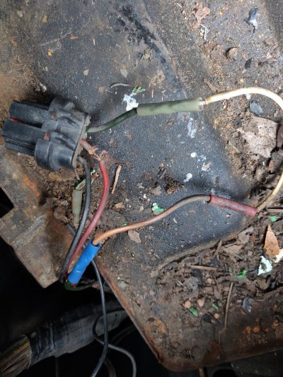

I didn't have a lot going on today and figured I'd do my headlight wiring harness upgrade. A while back I asked selahdoor to discribe how to make the harness and he did, THANK YOU, @Selahdoor !!! Since I got the truck the high beams didn't work and I figured it was a wire chewed up by a mouse, and by doing the harness my assumption was that I would find it and fix that too. I replaced the headlight switch and connector a couple weeks ago, so I know that part is good. So I ordered relays the other day and got them in the mail and went at it this morning. You can see in the pictures why I assumed a mouse was at fault. Anyway it's done and everything is nice and clean, but still no high beams. It's not the floor switch either. There's a bad wire between the floor switch and headlight somewhere, but I can't find it. Is there a connecter or fuseable link I don't know about? I'm pretty sure I found the bare wire that was blowing the running light fuse too.
