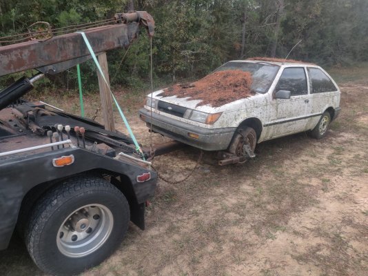

Towed my first car. It's a 88 Chevy spectrum. Took it straight to scrap metal, no hope, no title. But the truck did great, wheel lift was perfect....... happy, happy, happy! The stuff you find as a FedEx driver.
