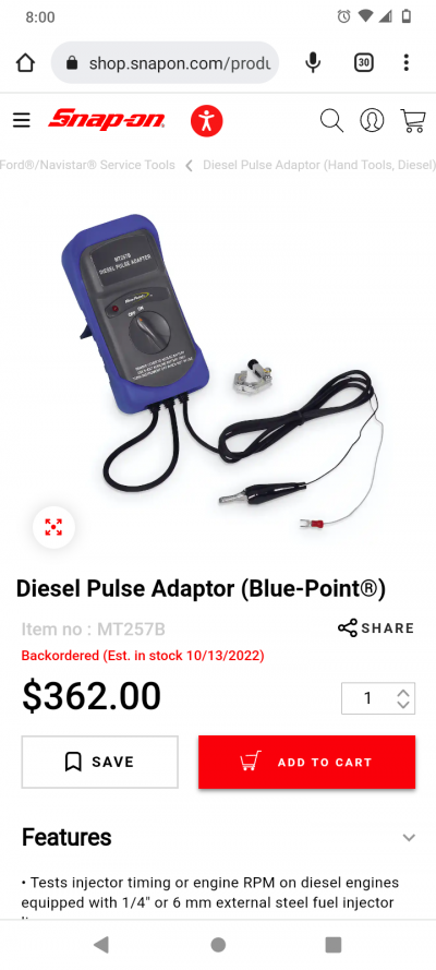

This is the timing tool I use and this is the trailer and toy I can't pull 55 mph.
