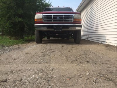

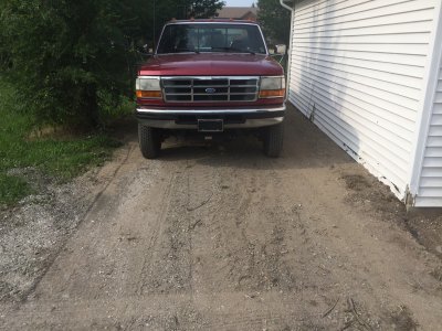

I'll check the toe first. Some other web reading was leading me to that conclusion as well. The dana 60 was in fine shape when I threw it under around 4500 miles ago, and in those 4500 miles this wear has been pretty minor, and included a good bit of snowplowing. But then again I don't expect much "road" tire wear while pushing at 5-15MPH in 4x4 on a slippery surface either.
Heres how she sits. Backed into this spot
