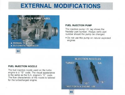

stanadyne code e is what came oem in your '93 idi n/a
stanadyne g codes came oem in the '93 factory turbo trucks
whats "best" (including aftermarket if you prefer) is whichever new set you install in place of 20 year old worn out ones.LOL
BB codes are the better injector to run turbo or not. I ran G codes in my built engine and they did not run well. I had less than 5000 miles on the last set when I installed Bb codes. It was a nite and day difference. Many will agree with the Bb codes being the best money can buy. Others wont. Buy new injectors od personally know who rebuilt your injectors. Buying from the lowest ebay seller is going to put you on the porch when they crap out on you shortly after the install.
but ask yourself this Gary; which is more likely to be the case?
a.that all 1993 and 1994 factory turbocharged idi trucks that rolled off the assembly line didn't run very well due to poor fuel injectors or;
b.you happened to buy a bad batch of fuel injectors of the same code?
if you really feel it's a.then why were there no reported problems back in the day when the trucks rolled off the lots? and why do some of us running g codes experience no such issues either right?
I don't recall where I got my G codes but.. I ran they for years on my rig. I had a shop install the first set because I felt I could not do it. They replaced the original injectors because the truck had 34,000 miles on it when I purchased it in 04. I was able to install the next 2 sets. They were new injectors. They were ok and I felt they were fine.. Till I tried a set of BB codes. Thats when I saw and felt the huge power increase and mileage increase. I have no doubt these G code injectors were not defective. People get the misconception that G codes are a turbo only injector. Thats not so. they will run in any idi. They were designed for the turbo engine. Many of us feel they were designed for the turbo because they engines could not pass emissions that year even with more air forced into the cylinders. So an emissions type injector was made especially for the turbo engines. The G codes have a much different pintle and they have a higher pop pressure. Its 2200 or 2300 lbs. I have posted videos of what the BB and G code pintales looks like. Just search for it on this site
