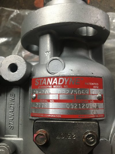

I found this pump for sale. He bought it a "few years ago" but got rid of the truck before installing it.
He can't remember where he got it. I'm assuming it's a crappy reman. from an auto parts chain.
But I'm wondering if there's any way to tell if it's OEM new? It has a pristine Stanadyne serial # plate on it.
Or if it was rebuilt by one of the reputable rebuilders, do they "sign" their work anywhere that I could look for?

I’ve read that the red tag is remanufactured by authorized shop. I think the 277R may indicate rebuilt.
Send one of the pump guys on here that picture, I’m sure they could help.
Found this in an old 2011 post
DB2-5013 - 1992-1994 manual tranny
DB2-5028 - 1992 -1994 auto tranny
DB2-5069 - 1993 -1994 turbo auto tranny
DB2-5070 - 1993 - 1994 turbo manual tranny
All of these injection pumps should have the external fuel adjustment screw.

If he only wants $200-300 buy it, if it does not work it will likely be a good core. Some of the rebuilders recommened on this site charge $300-500 for a core price. If the IP you send in is trash and not rebuildable you have to pay the core charge.

The tag on the pump that I posted above confirms that it was done by a certified rebuilder. And I can get it for $500 (or might could talk him down a bit).
