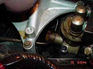

I just did mine... you will need a 1 1/4 wrench bent like a Z kind of... this is for the banjo nut, that was about the hardest part and then getting it back in. all the other stuff is easy.LOL

I'm not sure that removing the turbo wouldn't make this job a lot easier. I replaced my pump without removing the turbo, but it sure would make that banjo bolt easier to get. I didn't have problems getting it off, but re-threading that bad boy ate my sack lunch!
