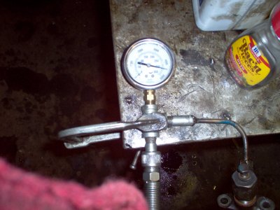

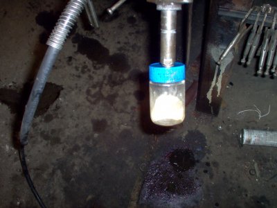

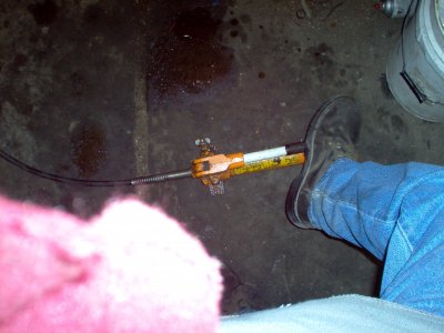

Good idea on the home made tester I made one for ***** and grins I used a porta power i had and the 3/8 pipe thread quick connect a 3/8 tee a 5000psi gauge and to hook up the injector I took a 3/8 pipe cut it off slid an old injector line inside and welded it held up to over 5000 psi without exploding but I was getting tense when the gauge went around back to 1000psi I tested some old idi injectors poped at around 1800-2000 psi and had a straight stream Is that normal and can they be adjusted like some other injectors. I also tested some 401 ford direct injectors to around 4200 psi they pop and shoot out 4 jets i could adjust them from 2000- over 5000 psi, are they different because thet're di.

What fluid are you using to test with? You will get a narrow stream with oil.
Alldata says that the opening pressure should be 1875 +/- 75 for a new injector and 1425 psi minimum, for a 1988 model. They can disassembled and shims changed to alter the pop pressure.
